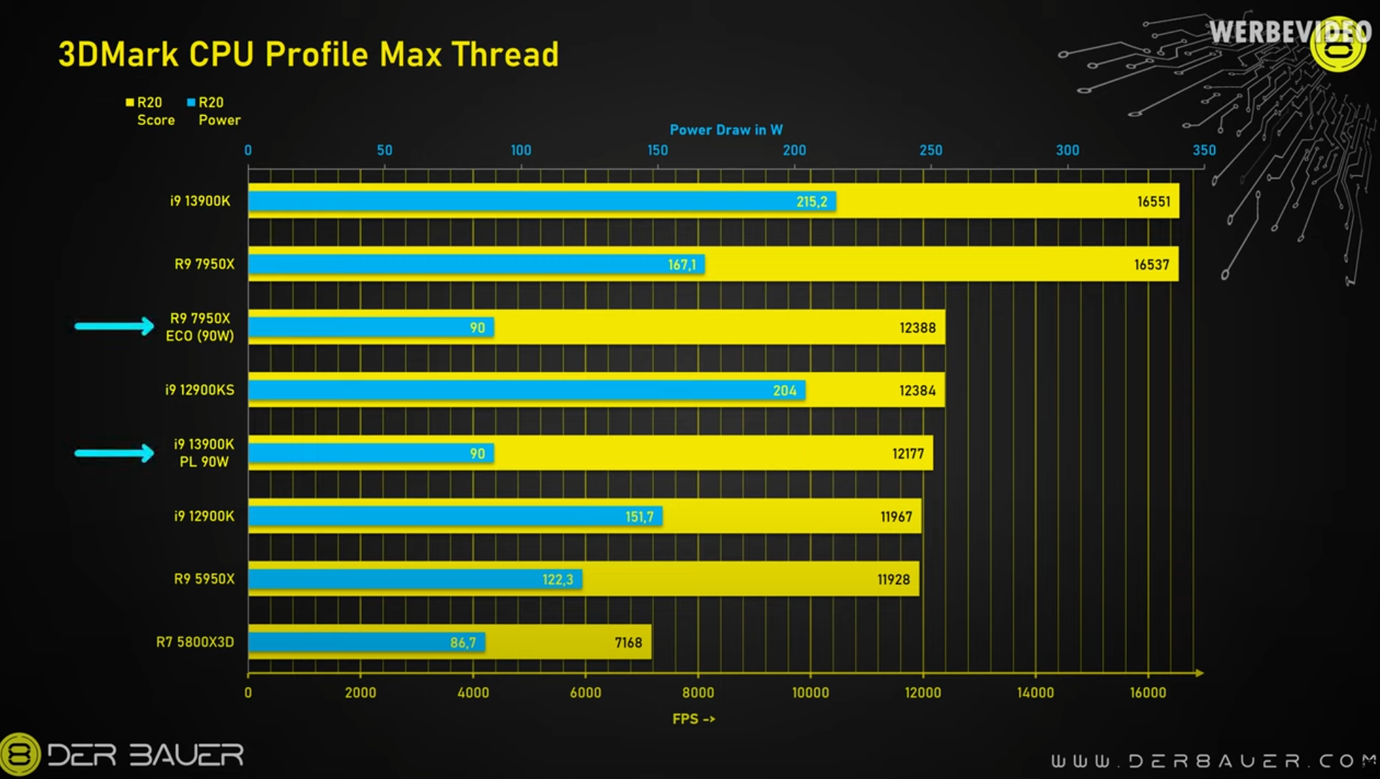

The 13900K does however use a lot more power to reach these higher frequencies so it might not actually be better silicon, just more voltage for higher clock (and more cores). We might actually see something similar with the the 13900KS, it seems like only 2 cores will reach 6Ghz with it and that might be only due to higher voltage.
So the 13900KS might not actually have better silicon than the 13900K (also meaning 13900KF will not be better than 13900K).
